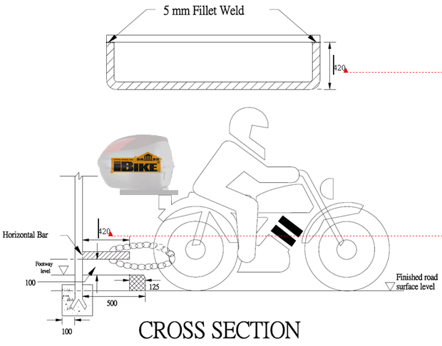

附上運輸署最新設計圖樣,請大家發表意見。
iBike 會把意見整理,然後在 5 Nov 2009 向運輸署反映。(Nov 05更新:給運輸署的建議請看p.9)
第一代和第二代的欄杆設計,問題在於尾箱會頂住欄杆,令尾輪與橫杆的距離太遠,細車很難使用。
http://www.iBike.com.hk/03_knowl ... hor_03/oct06/02.htm
TD had installed motorcycle parking security trial scheme at Sunning Road and Wyndham Street in May 2008 and Jan 2009 respectively.
Feedbacks from users were obtained saying that though the facility works satisfactorily with normal motorcycle,
the following difficulties were experienced for those motorcycles for which storage cubicles
are installed at the rear of the vehicle as:
(a) the cubicle will likely hit the top bar of the amenity railing during the parking maneuver; and
(b) with the cubicle, the motorcycle may not be parked with its rear wheel against the kerb.
This would increase the distance between the wheel and the bar provided for attaching the chain lock
resulting in the situation that the normal length of the chain lock would not be long enough
for attaching the wheel to the facility provided.

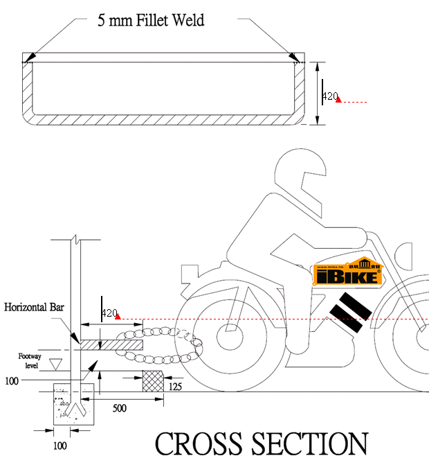

以下是第三代設計,主要修改是為了照顧有尾箱的電單車。欄杆向後移了,同時加長橫杆伸出的長度,
製造了一個空間讓尾箱"縮"入泊位內。
上圖有尾箱的圖片是iBike模擬說明
(i) provide the standard clearance of 500mm from the kerb line.
               This clearance distance would accommodate the cubicle installed at most of the motorcycles;
(ii) lower the horizontal bar to provide a vertical clearance of about 100mm above footpath; and
(iii) extend the position of the horizontal bar to about 80 mm from the kerb line.
                This would enable chain lock of nominal length be used to secure the motorcycle.
以下是運輸署原圖:
 樓主| 發表於 2-11-2009 14:11:38 | 顯示全部樓層
由於設計者很可能並不是電單車常客,設計時又要顧及其他道路使用者及其他工程的需要,所以呎吋很可能未能盡如人意。
不過還是請駕駛不同車種的館友看一看,呎吋上有有沒有一些地方會出現問題。
否則做完又係冇人用,白白浪費公帑

唔得
其實最好就好似圓方咁
植左右2邊
一來可以防止一格多車
二來鎖車唔需要好長既鐵鍊

條欄杆縮咗入去 500mm, 如果係行人路的話咪窄咗好多?

點解要整咁高既欄杆?
俾人掛招牌?鎖單車?
實際使用時係人都行去後面鎖
d雜物阻住晒咪又係鎖唔倒...
 樓主| 發表於 2-11-2009 15:08:01 | 顯示全部樓層
原帖由 faytong 於 2-11-2009 03:06 PM 發表
點解要整咁高既欄杆?
俾人掛招牌?鎖單車?
實際使用時係人都行去後面鎖
d雜物阻住晒咪又係鎖唔倒...
欄桿唔可以太低,以免行人不為意俾低欄kick倒
發表於 2-11-2009 15:11:42 | 顯示全部樓層
  以后咪要帶埋條大鐵鏈出車 ..........
